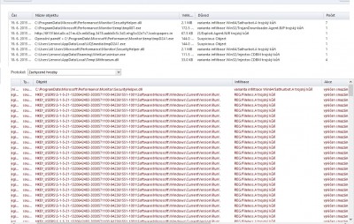

Asi už 3 dny mi Eset stále opakuje tyto hrozby a infiltrace -> horní je z karantény a dolní z protokolů. Jednu infiltraci mi opakoval 100x.
Nevím si s tím vůbec rady jak se toho zbavit. Budu moc rád za každou radu.
Děkuji :-)

Zde posílám log z každého toho programu.

Trojan.Sathurbot, C:\ProgramData\Microsoft\Performance\Monitor\SecurityCache\cache\resume\53300681bf06d8cd4a29a4eef8256979, , [7e3bcdf00e7c0135355d6c87c83bad53],
Trojan.Sathurbot, C:\ProgramData\Microsoft\Performance\Monitor\SecurityCache\cache\resume\5796bcc07cbb2cda2efb9eee3798e749, , [7e3bcdf00e7c0135355d6c87c83bad53],
Trojan.Sathurbot, C:\ProgramData\Microsoft\Performance\Monitor\SecurityCache\cache\resume\6380b49e0020bec1affc1c2ffbc79660, , [7e3bcdf00e7c0135355d6c87c83bad53],
Trojan.Sathurbot, C:\ProgramData\Microsoft\Performance\Monitor\SecurityCache\cache\resume\70b67386f19eeb69314be61c09dfe702, , [7e3bcdf00e7c0135355d6c87c83bad53],
Trojan.Sathurbot, C:\ProgramData\Microsoft\Performance\Monitor\SecurityCache\cache\resume\70dc66296b2d1ef53d5ff050e08cb527, , [7e3bcdf00e7c0135355d6c87c83bad53],
Trojan.Sathurbot, C:\ProgramData\Microsoft\Performance\Monitor\SecurityCache\cache\resume\72e85f85f59c90941e6e08f54a3bd4ca, , [7e3bcdf00e7c0135355d6c87c83bad53],
Trojan.Sathurbot, C:\ProgramData\Microsoft\Performance\Monitor\SecurityCache\cache\resume\8519dc14775b5d802da81b4c850992fa, , [7e3bcdf00e7c0135355d6c87c83bad53],
Trojan.Sathurbot, C:\ProgramData\Microsoft\Performance\Monitor\SecurityCache\cache\resume\a65324063d01973e672b725fab36bb6e, , [7e3bcdf00e7c0135355d6c87c83bad53],
Trojan.Sathurbot, C:\ProgramData\Microsoft\Performance\Monitor\SecurityCache\cache\resume\b9de4a4371d5e2eb97637e942fdfd4b9, , [7e3bcdf00e7c0135355d6c87c83bad53],
Trojan.Sathurbot, C:\ProgramData\Microsoft\Performance\Monitor\SecurityCache\cache\resume\bc3ed0279228b37bf52f0d8e8dcf81b2, , [7e3bcdf00e7c0135355d6c87c83bad53],
Trojan.Sathurbot, C:\ProgramData\Microsoft\Performance\Monitor\SecurityCache\cache\resume\be196a8ea5dc148896d79dd6b9fed868, , [7e3bcdf00e7c0135355d6c87c83bad53],
Trojan.Sathurbot, C:\ProgramData\Microsoft\Performance\Monitor\SecurityCache\cache\resume\c40d98b79bac0c7b0ea3c0cc9a1bfc70, , [7e3bcdf00e7c0135355d6c87c83bad53],
Trojan.Sathurbot, C:\ProgramData\Microsoft\Performance\Monitor\SecurityCache\cache\resume\cc9539033650fa2e4e0fa565ed296de4, , [7e3bcdf00e7c0135355d6c87c83bad53],
Trojan.Sathurbot, C:\ProgramData\Microsoft\Performance\Monitor\SecurityCache\cache\resume\d7f43d377ecd245f2e40e1e4d8018158, , [7e3bcdf00e7c0135355d6c87c83bad53],
Trojan.Sathurbot, C:\ProgramData\Microsoft\Performance\Monitor\SecurityCache\cache\resume\e816d0bbcebc18f1837aad16171798a6, , [7e3bcdf00e7c0135355d6c87c83bad53],
Trojan.Sathurbot, C:\ProgramData\Microsoft\Performance\Monitor\SecurityCache\cache\resume\ea38836ea45a37832eab79355c0bc2d9, , [7e3bcdf00e7c0135355d6c87c83bad53],
Trojan.Sathurbot, C:\ProgramData\Microsoft\Performance\Monitor\SecurityCache\cache\resume\f693d20f01d58120a1a6101701c0e23c, , [7e3bcdf00e7c0135355d6c87c83bad53],
Trojan.Sathurbot, C:\ProgramData\Microsoft\Performance\Monitor\SecurityCache\cache\resume\fece1eee3c6733bff5e297f082e304d5, , [7e3bcdf00e7c0135355d6c87c83bad53],
Trojan.Sathurbot, C:\ProgramData\Microsoft\Performance\Monitor\SecurityCache\cache\rules\0734d39cfb8b071990d4886f2d949a3b, , [7e3bcdf00e7c0135355d6c87c83bad53],
Trojan.Sathurbot, C:\ProgramData\Microsoft\Performance\Monitor\SecurityCache\cache\rules\1796e7d6e66fced6b67278be55ac8792, , [7e3bcdf00e7c0135355d6c87c83bad53],
Trojan.Sathurbot, C:\ProgramData\Microsoft\Performance\Monitor\SecurityCache\cache\rules\25c3c77067e1c76ae25ec7e469130747, , [7e3bcdf00e7c0135355d6c87c83bad53],
Trojan.Sathurbot, C:\ProgramData\Microsoft\Performance\Monitor\SecurityCache\cache\rules\3243f2e2dd6dcbdf1d5a864320a81d97, , [7e3bcdf00e7c0135355d6c87c83bad53],
Trojan.Sathurbot, C:\ProgramData\Microsoft\Performance\Monitor\SecurityCache\cache\rules\388259f596ebc79086bef6b622fa89ea, , [7e3bcdf00e7c0135355d6c87c83bad53],
Trojan.Sathurbot, C:\ProgramData\Microsoft\Performance\Monitor\SecurityCache\cache\rules\40a980d07864cb2d3bc536509ceb2fbf, , [7e3bcdf00e7c0135355d6c87c83bad53],
Trojan.Sathurbot, C:\ProgramData\Microsoft\Performance\Monitor\SecurityCache\cache\rules\53300681bf06d8cd4a29a4eef8256979, , [7e3bcdf00e7c0135355d6c87c83bad53],
Trojan.Sathurbot, C:\ProgramData\Microsoft\Performance\Monitor\SecurityCache\cache\rules\5796bcc07cbb2cda2efb9eee3798e749, , [7e3bcdf00e7c0135355d6c87c83bad53],
Trojan.Sathurbot, C:\ProgramData\Microsoft\Performance\Monitor\SecurityCache\cache\rules\6380b49e0020bec1affc1c2ffbc79660, , [7e3bcdf00e7c0135355d6c87c83bad53],
Trojan.Sathurbot, C:\ProgramData\Microsoft\Performance\Monitor\SecurityCache\cache\rules\70b67386f19eeb69314be61c09dfe702, , [7e3bcdf00e7c0135355d6c87c83bad53],
Trojan.Sathurbot, C:\ProgramData\Microsoft\Performance\Monitor\SecurityCache\cache\rules\70dc66296b2d1ef53d5ff050e08cb527, , [7e3bcdf00e7c0135355d6c87c83bad53],
Trojan.Sathurbot, C:\ProgramData\Microsoft\Performance\Monitor\SecurityCache\cache\rules\72e85f85f59c90941e6e08f54a3bd4ca, , [7e3bcdf00e7c0135355d6c87c83bad53],
Trojan.Sathurbot, C:\ProgramData\Microsoft\Performance\Monitor\SecurityCache\cache\rules\8519dc14775b5d802da81b4c850992fa, , [7e3bcdf00e7c0135355d6c87c83bad53],
Trojan.Sathurbot, C:\ProgramData\Microsoft\Performance\Monitor\SecurityCache\cache\rules\a65324063d01973e672b725fab36bb6e, , [7e3bcdf00e7c0135355d6c87c83bad53],
Trojan.Sathurbot, C:\ProgramData\Microsoft\Performance\Monitor\SecurityCache\cache\rules\b9de4a4371d5e2eb97637e942fdfd4b9, , [7e3bcdf00e7c0135355d6c87c83bad53],
Trojan.Sathurbot, C:\ProgramData\Microsoft\Performance\Monitor\SecurityCache\cache\rules\bc3ed0279228b37bf52f0d8e8dcf81b2, , [7e3bcdf00e7c0135355d6c87c83bad53],
Trojan.Sathurbot, C:\ProgramData\Microsoft\Performance\Monitor\SecurityCache\cache\rules\be196a8ea5dc148896d79dd6b9fed868, , [7e3bcdf00e7c0135355d6c87c83bad53],
Trojan.Sathurbot, C:\ProgramData\Microsoft\Performance\Monitor\SecurityCache\cache\rules\c40d98b79bac0c7b0ea3c0cc9a1bfc70, , [7e3bcdf00e7c0135355d6c87c83bad53],
Trojan.Sathurbot, C:\ProgramData\Microsoft\Performance\Monitor\SecurityCache\cache\rules\cc9539033650fa2e4e0fa565ed296de4, , [7e3bcdf00e7c0135355d6c87c83bad53],
Trojan.Sathurbot, C:\ProgramData\Microsoft\Performance\Monitor\SecurityCache\cache\rules\d7f43d377ecd245f2e40e1e4d8018158, , [7e3bcdf00e7c0135355d6c87c83bad53],
Trojan.Sathurbot, C:\ProgramData\Microsoft\Performance\Monitor\SecurityCache\cache\rules\e816d0bbcebc18f1837aad16171798a6, , [7e3bcdf00e7c0135355d6c87c83bad53],
Trojan.Sathurbot, C:\ProgramData\Microsoft\Performance\Monitor\SecurityCache\cache\rules\ea38836ea45a37832eab79355c0bc2d9, , [7e3bcdf00e7c0135355d6c87c83bad53],
Trojan.Sathurbot, C:\ProgramData\Microsoft\Performance\Monitor\SecurityCache\cache\rules\f693d20f01d58120a1a6101701c0e23c, , [7e3bcdf00e7c0135355d6c87c83bad53],
Trojan.Sathurbot, C:\ProgramData\Microsoft\Performance\Monitor\SecurityCache\cache\rules\fece1eee3c6733bff5e297f082e304d5, , [7e3bcdf00e7c0135355d6c87c83bad53],
Trojan.Sathurbot, C:\ProgramData\Microsoft\Performance\Monitor\SecurityCache\data\0734d39cfb8b071990d4886f2d949a3b\Lite x264 Codec Pack.exe, , [7e3bcdf00e7c0135355d6c87c83bad53],
Trojan.Sathurbot, C:\ProgramData\Microsoft\Performance\Monitor\SecurityCache\data\0734d39cfb8b071990d4886f2d949a3b\Tusk 2014.avi, , [7e3bcdf00e7c0135355d6c87c83bad53],
Trojan.Sathurbot, C:\ProgramData\Microsoft\Performance\Monitor\SecurityCache\data\0734d39cfb8b071990d4886f2d949a3b\Tusk 2014.nfo, , [7e3bcdf00e7c0135355d6c87c83bad53],
Trojan.Sathurbot, C:\ProgramData\Microsoft\Performance\Monitor\SecurityCache\data\1796e7d6e66fced6b67278be55ac8792\Satellite TV For PC 2011 Elite Edition.exe, , [7e3bcdf00e7c0135355d6c87c83bad53],
Trojan.Sathurbot, C:\ProgramData\Microsoft\Performance\Monitor\SecurityCache\data\1796e7d6e66fced6b67278be55ac8792\Satellite TV For PC 2011 Elite Edition.nfo, , [7e3bcdf00e7c0135355d6c87c83bad53],
Trojan.Sathurbot, C:\ProgramData\Microsoft\Performance\Monitor\SecurityCache\data\25c3c77067e1c76ae25ec7e469130747\Lite x264 Codec Pack.exe, , [7e3bcdf00e7c0135355d6c87c83bad53],
Trojan.Sathurbot, C:\ProgramData\Microsoft\Performance\Monitor\SecurityCache\data\25c3c77067e1c76ae25ec7e469130747\While Were Young 2014.avi, , [7e3bcdf00e7c0135355d6c87c83bad53],
Trojan.Sathurbot, C:\ProgramData\Microsoft\Performance\Monitor\SecurityCache\data\25c3c77067e1c76ae25ec7e469130747\While Were Young 2014.nfo, , [7e3bcdf00e7c0135355d6c87c83bad53],
Trojan.Sathurbot, C:\ProgramData\Microsoft\Performance\Monitor\SecurityCache\data\3243f2e2dd6dcbdf1d5a864320a81d97\Yahoo! Toolbar.exe, , [7e3bcdf00e7c0135355d6c87c83bad53],
Trojan.Sathurbot, C:\ProgramData\Microsoft\Performance\Monitor\SecurityCache\data\3243f2e2dd6dcbdf1d5a864320a81d97\Yahoo! Toolbar.nfo, , [7e3bcdf00e7c0135355d6c87c83bad53],
Trojan.Sathurbot, C:\ProgramData\Microsoft\Performance\Monitor\SecurityCache\data\388259f596ebc79086bef6b622fa89ea\Professional Bartender.exe, , [7e3bcdf00e7c0135355d6c87c83bad53],
Trojan.Sathurbot, C:\ProgramData\Microsoft\Performance\Monitor\SecurityCache\data\388259f596ebc79086bef6b622fa89ea\Professional Bartender.nfo, , [7e3bcdf00e7c0135355d6c87c83bad53],
Trojan.Sathurbot, C:\ProgramData\Microsoft\Performance\Monitor\SecurityCache\data\40a980d07864cb2d3bc536509ceb2fbf\Silver Efex Pro.exe, , [7e3bcdf00e7c0135355d6c87c83bad53],
Trojan.Sathurbot, C:\ProgramData\Microsoft\Performance\Monitor\SecurityCache\data\40a980d07864cb2d3bc536509ceb2fbf\Silver Efex Pro.nfo, , [7e3bcdf00e7c0135355d6c87c83bad53],
Trojan.Sathurbot, C:\ProgramData\Microsoft\Performance\Monitor\SecurityCache\data\53300681bf06d8cd4a29a4eef8256979\Lite x264 Codec Pack.exe, , [7e3bcdf00e7c0135355d6c87c83bad53],
Trojan.Sathurbot, C:\ProgramData\Microsoft\Performance\Monitor\SecurityCache\data\53300681bf06d8cd4a29a4eef8256979\Wild Card 2015.avi, , [7e3bcdf00e7c0135355d6c87c83bad53],
Trojan.Sathurbot, C:\ProgramData\Microsoft\Performance\Monitor\SecurityCache\data\53300681bf06d8cd4a29a4eef8256979\Wild Card 2015.nfo, , [7e3bcdf00e7c0135355d6c87c83bad53],
Trojan.Sathurbot, C:\ProgramData\Microsoft\Performance\Monitor\SecurityCache\data\5796bcc07cbb2cda2efb9eee3798e749\Lite x264 Codec Pack.exe, , [7e3bcdf00e7c0135355d6c87c83bad53],
Trojan.Sathurbot, C:\ProgramData\Microsoft\Performance\Monitor\SecurityCache\data\5796bcc07cbb2cda2efb9eee3798e749\Whiplash 2014.avi, , [7e3bcdf00e7c0135355d6c87c83bad53],
Trojan.Sathurbot, C:\ProgramData\Microsoft\Performance\Monitor\SecurityCache\data\5796bcc07cbb2cda2efb9eee3798e749\Whiplash 2014.nfo, , [7e3bcdf00e7c0135355d6c87c83bad53],
Trojan.Sathurbot, C:\ProgramData\Microsoft\Performance\Monitor\SecurityCache\data\6380b49e0020bec1affc1c2ffbc79660\Lite x264 Codec Pack.exe, , [7e3bcdf00e7c0135355d6c87c83bad53],
Trojan.Sathurbot, C:\ProgramData\Microsoft\Performance\Monitor\SecurityCache\data\6380b49e0020bec1affc1c2ffbc79660\Pitch Perfect 2 2015.avi, , [7e3bcdf00e7c0135355d6c87c83bad53],
Trojan.Sathurbot, C:\ProgramData\Microsoft\Performance\Monitor\SecurityCache\data\6380b49e0020bec1affc1c2ffbc79660\Pitch Perfect 2 2015.nfo, , [7e3bcdf00e7c0135355d6c87c83bad53],
Trojan.Sathurbot, C:\ProgramData\Microsoft\Performance\Monitor\SecurityCache\data\70b67386f19eeb69314be61c09dfe702\Lite x264 Codec Pack.exe, , [7e3bcdf00e7c0135355d6c87c83bad53],
Trojan.Sathurbot, C:\ProgramData\Microsoft\Performance\Monitor\SecurityCache\data\70b67386f19eeb69314be61c09dfe702\The Signal 2014.avi, , [7e3bcdf00e7c0135355d6c87c83bad53],
Trojan.Sathurbot, C:\ProgramData\Microsoft\Performance\Monitor\SecurityCache\data\70b67386f19eeb69314be61c09dfe702\The Signal 2014.nfo, , [7e3bcdf00e7c0135355d6c87c83bad53],
Trojan.Sathurbot, C:\ProgramData\Microsoft\Performance\Monitor\SecurityCache\data\70dc66296b2d1ef53d5ff050e08cb527\JProfiler.exe, , [7e3bcdf00e7c0135355d6c87c83bad53],
Trojan.Sathurbot, C:\ProgramData\Microsoft\Performance\Monitor\SecurityCache\data\70dc66296b2d1ef53d5ff050e08cb527\JProfiler.nfo, , [7e3bcdf00e7c0135355d6c87c83bad53],
Trojan.Sathurbot, C:\ProgramData\Microsoft\Performance\Monitor\SecurityCache\data\72e85f85f59c90941e6e08f54a3bd4ca\Lite x264 Codec Pack.exe, , [7e3bcdf00e7c0135355d6c87c83bad53],
Trojan.Sathurbot, C:\ProgramData\Microsoft\Performance\Monitor\SecurityCache\data\72e85f85f59c90941e6e08f54a3bd4ca\Still Alice 2014.avi, , [7e3bcdf00e7c0135355d6c87c83bad53],
Trojan.Sathurbot, C:\ProgramData\Microsoft\Performance\Monitor\SecurityCache\data\72e85f85f59c90941e6e08f54a3bd4ca\Still Alice 2014.nfo, , [7e3bcdf00e7c0135355d6c87c83bad53],
Trojan.Sathurbot, C:\ProgramData\Microsoft\Performance\Monitor\SecurityCache\data\8519dc14775b5d802da81b4c850992fa\Mobile Master.exe, , [7e3bcdf00e7c0135355d6c87c83bad53],
Trojan.Sathurbot, C:\ProgramData\Microsoft\Performance\Monitor\SecurityCache\data\8519dc14775b5d802da81b4c850992fa\Mobile Master.nfo, , [7e3bcdf00e7c0135355d6c87c83bad53],
Trojan.Sathurbot, C:\ProgramData\Microsoft\Performance\Monitor\SecurityCache\data\a65324063d01973e672b725fab36bb6e\Lite x264 Codec Pack.exe, , [7e3bcdf00e7c0135355d6c87c83bad53],
Trojan.Sathurbot, C:\ProgramData\Microsoft\Performance\Monitor\SecurityCache\data\a65324063d01973e672b725fab36bb6e\The Good Dinosaur 2015.avi, , [7e3bcdf00e7c0135355d6c87c83bad53],
Trojan.Sathurbot, C:\ProgramData\Microsoft\Performance\Monitor\SecurityCache\data\a65324063d01973e672b725fab36bb6e\The Good Dinosaur 2015.nfo, , [7e3bcdf00e7c0135355d6c87c83bad53],
Trojan.Sathurbot, C:\ProgramData\Microsoft\Performance\Monitor\SecurityCache\data\b9de4a4371d5e2eb97637e942fdfd4b9\PhotoScore Ultimate.exe, , [7e3bcdf00e7c0135355d6c87c83bad53],
Trojan.Sathurbot, C:\ProgramData\Microsoft\Performance\Monitor\SecurityCache\data\b9de4a4371d5e2eb97637e942fdfd4b9\PhotoScore Ultimate.nfo, , [7e3bcdf00e7c0135355d6c87c83bad53],
Trojan.Sathurbot, C:\ProgramData\Microsoft\Performance\Monitor\SecurityCache\data\bc3ed0279228b37bf52f0d8e8dcf81b2\Lite x264 Codec Pack.exe, , [7e3bcdf00e7c0135355d6c87c83bad53],
Trojan.Sathurbot, C:\ProgramData\Microsoft\Performance\Monitor\SecurityCache\data\bc3ed0279228b37bf52f0d8e8dcf81b2\Unfriended 2014.avi, , [7e3bcdf00e7c0135355d6c87c83bad53],
Trojan.Sathurbot, C:\ProgramData\Microsoft\Performance\Monitor\SecurityCache\data\bc3ed0279228b37bf52f0d8e8dcf81b2\Unfriended 2014.nfo, , [7e3bcdf00e7c0135355d6c87c83bad53],
Trojan.Sathurbot, C:\ProgramData\Microsoft\Performance\Monitor\SecurityCache\data\be196a8ea5dc148896d79dd6b9fed868\Ultra Video Splitter.exe, , [7e3bcdf00e7c0135355d6c87c83bad53],
Trojan.Sathurbot, C:\ProgramData\Microsoft\Performance\Monitor\SecurityCache\data\be196a8ea5dc148896d79dd6b9fed868\Ultra Video Splitter.nfo, , [7e3bcdf00e7c0135355d6c87c83bad53],
Trojan.Sathurbot, C:\ProgramData\Microsoft\Performance\Monitor\SecurityCache\data\c40d98b79bac0c7b0ea3c0cc9a1bfc70\Macro Scheduler Automation Tool.exe, , [7e3bcdf00e7c0135355d6c87c83bad53],
Trojan.Sathurbot, C:\ProgramData\Microsoft\Performance\Monitor\SecurityCache\data\c40d98b79bac0c7b0ea3c0cc9a1bfc70\Macro Scheduler Automation Tool.nfo, , [7e3bcdf00e7c0135355d6c87c83bad53],
Trojan.Sathurbot, C:\ProgramData\Microsoft\Performance\Monitor\SecurityCache\data\cc9539033650fa2e4e0fa565ed296de4\Home 2015.avi, , [7e3bcdf00e7c0135355d6c87c83bad53],
Trojan.Sathurbot, C:\ProgramData\Microsoft\Performance\Monitor\SecurityCache\data\cc9539033650fa2e4e0fa565ed296de4\Home 2015.nfo, , [7e3bcdf00e7c0135355d6c87c83bad53],
Trojan.Sathurbot, C:\ProgramData\Microsoft\Performance\Monitor\SecurityCache\data\cc9539033650fa2e4e0fa565ed296de4\Lite x264 Codec Pack.exe, , [7e3bcdf00e7c0135355d6c87c83bad53],
Trojan.Sathurbot, C:\ProgramData\Microsoft\Performance\Monitor\SecurityCache\data\d7f43d377ecd245f2e40e1e4d8018158\Lite x264 Codec Pack.exe, , [7e3bcdf00e7c0135355d6c87c83bad53],
Trojan.Sathurbot, C:\ProgramData\Microsoft\Performance\Monitor\SecurityCache\data\d7f43d377ecd245f2e40e1e4d8018158\The Age of Adaline 2015.avi, , [7e3bcdf00e7c0135355d6c87c83bad53],
Trojan.Sathurbot, C:\ProgramData\Microsoft\Performance\Monitor\SecurityCache\data\d7f43d377ecd245f2e40e1e4d8018158\The Age of Adaline 2015.nfo, , [7e3bcdf00e7c0135355d6c87c83bad53],
Trojan.Sathurbot, C:\ProgramData\Microsoft\Performance\Monitor\SecurityCache\data\e816d0bbcebc18f1837aad16171798a6\Lite x264 Codec Pack.exe, , [7e3bcdf00e7c0135355d6c87c83bad53],
Trojan.Sathurbot, C:\ProgramData\Microsoft\Performance\Monitor\SecurityCache\data\e816d0bbcebc18f1837aad16171798a6\The Fault in Our Stars 2014.avi, , [7e3bcdf00e7c0135355d6c87c83bad53],
Trojan.Sathurbot, C:\ProgramData\Microsoft\Performance\Monitor\SecurityCache\data\e816d0bbcebc18f1837aad16171798a6\The Fault in Our Stars 2014.nfo, , [7e3bcdf00e7c0135355d6c87c83bad53],
Trojan.Sathurbot, C:\ProgramData\Microsoft\Performance\Monitor\SecurityCache\data\ea38836ea45a37832eab79355c0bc2d9\Kaspersky Anti-Virus.exe, , [7e3bcdf00e7c0135355d6c87c83bad53],
Trojan.Sathurbot, C:\ProgramData\Microsoft\Performance\Monitor\SecurityCache\data\ea38836ea45a37832eab79355c0bc2d9\Kaspersky Anti-Virus.nfo, , [7e3bcdf00e7c0135355d6c87c83bad53],
Trojan.Sathurbot, C:\ProgramData\Microsoft\Performance\Monitor\SecurityCache\data\ea38836ea45a37832eab79355c0bc2d9\Setup.dat, , [7e3bcdf00e7c0135355d6c87c83bad53],
Trojan.Sathurbot, C:\ProgramData\Microsoft\Performance\Monitor\SecurityCache\data\f693d20f01d58120a1a6101701c0e23c\Don Jon 2013.avi, , [7e3bcdf00e7c0135355d6c87c83bad53],
Trojan.Sathurbot, C:\ProgramData\Microsoft\Performance\Monitor\SecurityCache\data\f693d20f01d58120a1a6101701c0e23c\Don Jon 2013.nfo, , [7e3bcdf00e7c0135355d6c87c83bad53],
Trojan.Sathurbot, C:\ProgramData\Microsoft\Performance\Monitor\SecurityCache\data\f693d20f01d58120a1a6101701c0e23c\Lite x264 Codec Pack.exe, , [7e3bcdf00e7c0135355d6c87c83bad53],
Trojan.Sathurbot, C:\ProgramData\Microsoft\Performance\Monitor\SecurityCache\data\fece1eee3c6733bff5e297f082e304d5\Iron Man 3 2013.avi, , [7e3bcdf00e7c0135355d6c87c83bad53],
Trojan.Sathurbot, C:\ProgramData\Microsoft\Performance\Monitor\SecurityCache\data\fece1eee3c6733bff5e297f082e304d5\Iron Man 3 2013.nfo, , [7e3bcdf00e7c0135355d6c87c83bad53],
Trojan.Sathurbot, C:\ProgramData\Microsoft\Performance\Monitor\SecurityCache\data\fece1eee3c6733bff5e297f082e304d5\Lite x264 Codec Pack.exe, , [7e3bcdf00e7c0135355d6c87c83bad53],
Trojan.Sathurbot, C:\ProgramData\Microsoft\Performance\Monitor\temp\tmp1B56.tmp, , [7e3bcdf00e7c0135355d6c87c83bad53],
Trojan.Sathurbot, C:\ProgramData\Microsoft\Performance\Monitor\temp\tmp1B82.tmp, , [7e3bcdf00e7c0135355d6c87c83bad53],
Trojan.Sathurbot, C:\ProgramData\Microsoft\Performance\Monitor\temp\tmp22F5.tmp, , [7e3bcdf00e7c0135355d6c87c83bad53],
Trojan.Sathurbot, C:\ProgramData\Microsoft\Performance\Monitor\temp\tmp26E0.tmp, , [7e3bcdf00e7c0135355d6c87c83bad53],
Trojan.Sathurbot, C:\ProgramData\Microsoft\Performance\Monitor\temp\tmp294A.tmp, , [7e3bcdf00e7c0135355d6c87c83bad53],
Trojan.Sathurbot, C:\ProgramData\Microsoft\Performance\Monitor\temp\tmp2B22.tmp, , [7e3bcdf00e7c0135355d6c87c83bad53],
Trojan.Sathurbot, C:\ProgramData\Microsoft\Performance\Monitor\temp\tmp418C.tmp, , [7e3bcdf00e7c0135355d6c87c83bad53],
Trojan.Sathurbot, C:\ProgramData\Microsoft\Performance\Monitor\temp\tmp51C9.tmp, , [7e3bcdf00e7c0135355d6c87c83bad53],
Trojan.Sathurbot, C:\ProgramData\Microsoft\Performance\Monitor\temp\tmp5647.tmp, , [7e3bcdf00e7c0135355d6c87c83bad53],
Trojan.Sathurbot, C:\ProgramData\Microsoft\Performance\Monitor\temp\tmp59F6.tmp, , [7e3bcdf00e7c0135355d6c87c83bad53],
Trojan.Sathurbot, C:\ProgramData\Microsoft\Performance\Monitor\temp\tmp6874.tmp, , [7e3bcdf00e7c0135355d6c87c83bad53],
Trojan.Sathurbot, C:\ProgramData\Microsoft\Performance\Monitor\temp\tmp7451.tmp, , [7e3bcdf00e7c0135355d6c87c83bad53],
Trojan.Sathurbot, C:\ProgramData\Microsoft\Performance\Monitor\temp\tmp8605.tmp, , [7e3bcdf00e7c0135355d6c87c83bad53],
Trojan.Sathurbot, C:\ProgramData\Microsoft\Performance\Monitor\temp\tmp887.tmp, , [7e3bcdf00e7c0135355d6c87c83bad53],
Trojan.Sathurbot, C:\ProgramData\Microsoft\Performance\Monitor\temp\tmp99AB.tmp, , [7e3bcdf00e7c0135355d6c87c83bad53],
Trojan.Sathurbot, C:\ProgramData\Microsoft\Performance\Monitor\temp\tmpB8E9.tmp, , [7e3bcdf00e7c0135355d6c87c83bad53],
Trojan.Sathurbot, C:\ProgramData\Microsoft\Performance\Monitor\temp\tmpBD0D.tmp, , [7e3bcdf00e7c0135355d6c87c83bad53],
Trojan.Sathurbot, C:\ProgramData\Microsoft\Performance\Monitor\temp\tmpD2A1.tmp, , [7e3bcdf00e7c0135355d6c87c83bad53],
Trojan.Sathurbot, C:\ProgramData\Microsoft\Performance\Monitor\temp\tmpD9B0.tmp, , [7e3bcdf00e7c0135355d6c87c83bad53],
Trojan.Sathurbot, C:\ProgramData\Microsoft\Performance\Monitor\temp\tmpE49E.tmp, , [7e3bcdf00e7c0135355d6c87c83bad53],
Trojan.Sathurbot, C:\ProgramData\Microsoft\Performance\Monitor\temp\tmpE87B.tmp, , [7e3bcdf00e7c0135355d6c87c83bad53],
Trojan.Sathurbot, C:\ProgramData\Microsoft\Performance\Monitor\temp\tmpE87C.tmp, , [7e3bcdf00e7c0135355d6c87c83bad53],
Trojan.Sathurbot, C:\ProgramData\Microsoft\Performance\Monitor\temp\tmpE88.tmp, , [7e3bcdf00e7c0135355d6c87c83bad53],
Trojan.Sathurbot, C:\ProgramData\Microsoft\Performance\Monitor\temp\tmpEB8F.tmp, , [7e3bcdf00e7c0135355d6c87c83bad53],
Trojan.Sathurbot, C:\ProgramData\Microsoft\Performance\Monitor\temp\tmpF001.tmp, , [7e3bcdf00e7c0135355d6c87c83bad53],
Trojan.Sathurbot, C:\ProgramData\Microsoft\Performance\Monitor\temp\{FEE85F15-DBE4-5A31-E0EC-0ED0930FDBB5}, , [7e3bcdf00e7c0135355d6c87c83bad53],
Fyzické sektory: 0
(Nenalezeny žádné škodlivé položky)
(end)

Odahviing
Příspěvky: 21
Registrován: červen 15
Pohlaví: Muž
Stav:
Offline
Re: Prosím o pomoc
Příspěvekod Odahviing » 25 čer 2015 13:17
Vkládám log od každého uvedeného programu. Měl jsem, ale problém s Malwarebytes anti-malware. Protože jak jsem chtěl dát "Vymazat-Clean" tak program přestal pracovat, zkoušel jsem to i v nouzovém režimu a také mi psal, že neodpovídá.

OS: Windows 8.1 x64
Ran by Lenovo on źt 25. 06. 2015 at 12:39:30,96
~~~ Services
~~~ Tasks
~~~ Registry Values
~~~ Registry Keys
~~~ Files
~~~ Folders
~~~ Chrome
[C:\Users\Lenovo\appdata\local\Google\Chrome\User Data\Default\Preferences] - default search provider reset
[C:\Users\Lenovo\appdata\local\Google\Chrome\User Data\Default\Preferences] - Extensions Deleted:
[C:\Users\Lenovo\appdata\local\Google\Chrome\User Data\Default\Secure Preferences] - default search provider reset
[C:\Users\Lenovo\appdata\local\Google\Chrome\User Data\Default\Secure Preferences] - Extensions Deleted:
Scan was completed on źt 25. 06. 2015 at 12:42:58,49
End of JRT log

jerabina
člen Security týmu
Příspěvky: 3647
Registrován: březen 13
Bydliště: Litoměřice
Pohlaví: Muž
Stav:
Offline
Re: Prosím o pomoc
Příspěvekod jerabina » 25 čer 2015 14:07
Přesně stejný problém, že MBAM nechce mazat tuhle složku, jsme tu již měli, takže to vymažeme ručně.
Zavři všechny programy a prohlížeče. Deaktivuj antivir a firewall.
Prosím, odpoj všechny USB (kromě myši s klávesnice) nebo externí disky z počítače před spuštěním tohoto programu.
Spusť znovu RogueKiller ( Pro Windows Vista nebo Windows 7, klepni pravým a vyber "Spustit jako správce", ve Windows XP poklepej ke spuštění).
- Počkej, až Prescan dokončí práci...
- Pak klikni na "Prohledat " ,po jeho skončení:
- V záložkách (Registry , Tasks , Web Browser apod.) vše zatrhni (dej zatržítka)
(musíš dát myší zatržítko do toho čtverečku vlevo od registru ap.)
- Klikni na "Smazat"
- Počkej, dokud Status box nezobrazí " Mazání dokončeno "
- Klikni na "Zpráva " a zkopíruj a vlož obsah té zprávy prosím sem. Log je možno nalézt v RKreport [číslo]. txt na ploše.
- Zavři RogueKiller
Vypni antivir
Stáhni
Zoek.exe
a uloz si ho na plochu.
- pozor , náběh programu může trvat déle.
Kód: Vybrat vše
autoclean;
emptyclsid;
iedefaults;
FFdefaults;
CHRdefaults;
emptyalltemp;
resethosts;
klikni na Run Script
C:\zoek-results.log
Zkopíruj sem celý obsah toho logu.
Udělen nový sken MBAM a log sem vlož.
Prosím stáhni příslušnou verzi programu pro Tvůj systém 32-bit/64-bit Farbar Recovery Scan Tool (FRST)
32bit.:
http://www.bleepingcomputer.com/download/farbar-recovery-scan-tool/dl/81/
64bit.:
http://www.bleepingcomputer.com/download/farbar-recovery-scan-tool/dl/82/
a ulož jej na plochu. ,pak spusť FRST jako správce
Potvrď způsob užití.
Neměň žádné z výchozích nastavení a klikni na položku „Scan“ („Skenovat“) .Když je skenování dokončeno, ukážou se dva logy = FRST.txt a Addition.txt a uloží se na ploše.Prosím zkopíruj sem celý jejich obsah.
Když nevíš jak dál, přichází na řadu prostudovat manuál!
HJT návod
Pokud neodpovídám do vašich témat v sekci HJT když jsem online, tak je to jen proto, že jsem na mobilu kde je studování logů a psaní skriptů nemožné. Neberte to tedy prosím jako ignoraci.
Odahviing

Trojan.Sathurbot, C:\ProgramData\Microsoft\Performance\Monitor\SecurityCache\data\70dc66296b2d1ef53d5ff050e08cb527\JProfiler.exe, , [62afcdf32565b97d36ee52a219ea32ce],
Trojan.Sathurbot, C:\ProgramData\Microsoft\Performance\Monitor\SecurityCache\data\70dc66296b2d1ef53d5ff050e08cb527\JProfiler.nfo, , [62afcdf32565b97d36ee52a219ea32ce],
Trojan.Sathurbot, C:\ProgramData\Microsoft\Performance\Monitor\SecurityCache\data\72e85f85f59c90941e6e08f54a3bd4ca\Lite x264 Codec Pack.exe, , [62afcdf32565b97d36ee52a219ea32ce],
Trojan.Sathurbot, C:\ProgramData\Microsoft\Performance\Monitor\SecurityCache\data\72e85f85f59c90941e6e08f54a3bd4ca\Still Alice 2014.avi, , [62afcdf32565b97d36ee52a219ea32ce],
Trojan.Sathurbot, C:\ProgramData\Microsoft\Performance\Monitor\SecurityCache\data\72e85f85f59c90941e6e08f54a3bd4ca\Still Alice 2014.nfo, , [62afcdf32565b97d36ee52a219ea32ce],
Trojan.Sathurbot, C:\ProgramData\Microsoft\Performance\Monitor\SecurityCache\data\8519dc14775b5d802da81b4c850992fa\Mobile Master.exe, , [62afcdf32565b97d36ee52a219ea32ce],
Trojan.Sathurbot, C:\ProgramData\Microsoft\Performance\Monitor\SecurityCache\data\8519dc14775b5d802da81b4c850992fa\Mobile Master.nfo, , [62afcdf32565b97d36ee52a219ea32ce],
Trojan.Sathurbot, C:\ProgramData\Microsoft\Performance\Monitor\SecurityCache\data\a65324063d01973e672b725fab36bb6e\Lite x264 Codec Pack.exe, , [62afcdf32565b97d36ee52a219ea32ce],
Trojan.Sathurbot, C:\ProgramData\Microsoft\Performance\Monitor\SecurityCache\data\a65324063d01973e672b725fab36bb6e\The Good Dinosaur 2015.avi, , [62afcdf32565b97d36ee52a219ea32ce],
Trojan.Sathurbot, C:\ProgramData\Microsoft\Performance\Monitor\SecurityCache\data\a65324063d01973e672b725fab36bb6e\The Good Dinosaur 2015.nfo, , [62afcdf32565b97d36ee52a219ea32ce],
Trojan.Sathurbot, C:\ProgramData\Microsoft\Performance\Monitor\SecurityCache\data\b9de4a4371d5e2eb97637e942fdfd4b9\PhotoScore Ultimate.exe, , [62afcdf32565b97d36ee52a219ea32ce],
Trojan.Sathurbot, C:\ProgramData\Microsoft\Performance\Monitor\SecurityCache\data\b9de4a4371d5e2eb97637e942fdfd4b9\PhotoScore Ultimate.nfo, , [62afcdf32565b97d36ee52a219ea32ce],
Trojan.Sathurbot, C:\ProgramData\Microsoft\Performance\Monitor\SecurityCache\data\bc3ed0279228b37bf52f0d8e8dcf81b2\Lite x264 Codec Pack.exe, , [62afcdf32565b97d36ee52a219ea32ce],
Trojan.Sathurbot, C:\ProgramData\Microsoft\Performance\Monitor\SecurityCache\data\bc3ed0279228b37bf52f0d8e8dcf81b2\Unfriended 2014.avi, , [62afcdf32565b97d36ee52a219ea32ce],
Trojan.Sathurbot, C:\ProgramData\Microsoft\Performance\Monitor\SecurityCache\data\bc3ed0279228b37bf52f0d8e8dcf81b2\Unfriended 2014.nfo, , [62afcdf32565b97d36ee52a219ea32ce],
Trojan.Sathurbot, C:\ProgramData\Microsoft\Performance\Monitor\SecurityCache\data\be196a8ea5dc148896d79dd6b9fed868\Ultra Video Splitter.exe, , [62afcdf32565b97d36ee52a219ea32ce],
Trojan.Sathurbot, C:\ProgramData\Microsoft\Performance\Monitor\SecurityCache\data\be196a8ea5dc148896d79dd6b9fed868\Ultra Video Splitter.nfo, , [62afcdf32565b97d36ee52a219ea32ce],
Trojan.Sathurbot, C:\ProgramData\Microsoft\Performance\Monitor\SecurityCache\data\c40d98b79bac0c7b0ea3c0cc9a1bfc70\Macro Scheduler Automation Tool.exe, , [62afcdf32565b97d36ee52a219ea32ce],
Trojan.Sathurbot, C:\ProgramData\Microsoft\Performance\Monitor\SecurityCache\data\c40d98b79bac0c7b0ea3c0cc9a1bfc70\Macro Scheduler Automation Tool.nfo, , [62afcdf32565b97d36ee52a219ea32ce],
Trojan.Sathurbot, C:\ProgramData\Microsoft\Performance\Monitor\SecurityCache\data\cc9539033650fa2e4e0fa565ed296de4\Home 2015.avi, , [62afcdf32565b97d36ee52a219ea32ce],
Trojan.Sathurbot, C:\ProgramData\Microsoft\Performance\Monitor\SecurityCache\data\cc9539033650fa2e4e0fa565ed296de4\Home 2015.nfo, , [62afcdf32565b97d36ee52a219ea32ce],
Trojan.Sathurbot, C:\ProgramData\Microsoft\Performance\Monitor\SecurityCache\data\cc9539033650fa2e4e0fa565ed296de4\Lite x264 Codec Pack.exe, , [62afcdf32565b97d36ee52a219ea32ce],
Trojan.Sathurbot, C:\ProgramData\Microsoft\Performance\Monitor\SecurityCache\data\d7f43d377ecd245f2e40e1e4d8018158\Lite x264 Codec Pack.exe, , [62afcdf32565b97d36ee52a219ea32ce],
Trojan.Sathurbot, C:\ProgramData\Microsoft\Performance\Monitor\SecurityCache\data\d7f43d377ecd245f2e40e1e4d8018158\The Age of Adaline 2015.avi, , [62afcdf32565b97d36ee52a219ea32ce],
Trojan.Sathurbot, C:\ProgramData\Microsoft\Performance\Monitor\SecurityCache\data\d7f43d377ecd245f2e40e1e4d8018158\The Age of Adaline 2015.nfo, , [62afcdf32565b97d36ee52a219ea32ce],
Trojan.Sathurbot, C:\ProgramData\Microsoft\Performance\Monitor\SecurityCache\data\e816d0bbcebc18f1837aad16171798a6\Lite x264 Codec Pack.exe, , [62afcdf32565b97d36ee52a219ea32ce],
Trojan.Sathurbot, C:\ProgramData\Microsoft\Performance\Monitor\SecurityCache\data\e816d0bbcebc18f1837aad16171798a6\The Fault in Our Stars 2014.avi, , [62afcdf32565b97d36ee52a219ea32ce],
Trojan.Sathurbot, C:\ProgramData\Microsoft\Performance\Monitor\SecurityCache\data\e816d0bbcebc18f1837aad16171798a6\The Fault in Our Stars 2014.nfo, , [62afcdf32565b97d36ee52a219ea32ce],
Trojan.Sathurbot, C:\ProgramData\Microsoft\Performance\Monitor\SecurityCache\data\ea38836ea45a37832eab79355c0bc2d9\Kaspersky Anti-Virus.exe, , [62afcdf32565b97d36ee52a219ea32ce],
Trojan.Sathurbot, C:\ProgramData\Microsoft\Performance\Monitor\SecurityCache\data\ea38836ea45a37832eab79355c0bc2d9\Kaspersky Anti-Virus.nfo, , [62afcdf32565b97d36ee52a219ea32ce],
Trojan.Sathurbot, C:\ProgramData\Microsoft\Performance\Monitor\SecurityCache\data\ea38836ea45a37832eab79355c0bc2d9\Setup.dat, , [62afcdf32565b97d36ee52a219ea32ce],
Trojan.Sathurbot, C:\ProgramData\Microsoft\Performance\Monitor\SecurityCache\data\f693d20f01d58120a1a6101701c0e23c\Don Jon 2013.avi, , [62afcdf32565b97d36ee52a219ea32ce],
Trojan.Sathurbot, C:\ProgramData\Microsoft\Performance\Monitor\SecurityCache\data\f693d20f01d58120a1a6101701c0e23c\Don Jon 2013.nfo, , [62afcdf32565b97d36ee52a219ea32ce],
Trojan.Sathurbot, C:\ProgramData\Microsoft\Performance\Monitor\SecurityCache\data\f693d20f01d58120a1a6101701c0e23c\Lite x264 Codec Pack.exe, , [62afcdf32565b97d36ee52a219ea32ce],
Trojan.Sathurbot, C:\ProgramData\Microsoft\Performance\Monitor\SecurityCache\data\fece1eee3c6733bff5e297f082e304d5\Iron Man 3 2013.avi, , [62afcdf32565b97d36ee52a219ea32ce],
Trojan.Sathurbot, C:\ProgramData\Microsoft\Performance\Monitor\SecurityCache\data\fece1eee3c6733bff5e297f082e304d5\Iron Man 3 2013.nfo, , [62afcdf32565b97d36ee52a219ea32ce],
Trojan.Sathurbot, C:\ProgramData\Microsoft\Performance\Monitor\SecurityCache\data\fece1eee3c6733bff5e297f082e304d5\Lite x264 Codec Pack.exe, , [62afcdf32565b97d36ee52a219ea32ce],
Trojan.Sathurbot, C:\ProgramData\Microsoft\Performance\Monitor\temp\tmp1B56.tmp, , [62afcdf32565b97d36ee52a219ea32ce],
Trojan.Sathurbot, C:\ProgramData\Microsoft\Performance\Monitor\temp\tmp1B82.tmp, , [62afcdf32565b97d36ee52a219ea32ce],
Trojan.Sathurbot, C:\ProgramData\Microsoft\Performance\Monitor\temp\tmp22F5.tmp, , [62afcdf32565b97d36ee52a219ea32ce],
Trojan.Sathurbot, C:\ProgramData\Microsoft\Performance\Monitor\temp\tmp26E0.tmp, , [62afcdf32565b97d36ee52a219ea32ce],
Trojan.Sathurbot, C:\ProgramData\Microsoft\Performance\Monitor\temp\tmp294A.tmp, , [62afcdf32565b97d36ee52a219ea32ce],
Trojan.Sathurbot, C:\ProgramData\Microsoft\Performance\Monitor\temp\tmp2B22.tmp, , [62afcdf32565b97d36ee52a219ea32ce],
Trojan.Sathurbot, C:\ProgramData\Microsoft\Performance\Monitor\temp\tmp3A3A.tmp, , [62afcdf32565b97d36ee52a219ea32ce],
Trojan.Sathurbot, C:\ProgramData\Microsoft\Performance\Monitor\temp\tmp418C.tmp, , [62afcdf32565b97d36ee52a219ea32ce],
Trojan.Sathurbot, C:\ProgramData\Microsoft\Performance\Monitor\temp\tmp51C9.tmp, , [62afcdf32565b97d36ee52a219ea32ce],
Trojan.Sathurbot, C:\ProgramData\Microsoft\Performance\Monitor\temp\tmp5647.tmp, , [62afcdf32565b97d36ee52a219ea32ce],
Trojan.Sathurbot, C:\ProgramData\Microsoft\Performance\Monitor\temp\tmp59F6.tmp, , [62afcdf32565b97d36ee52a219ea32ce],
Trojan.Sathurbot, C:\ProgramData\Microsoft\Performance\Monitor\temp\tmp6874.tmp, , [62afcdf32565b97d36ee52a219ea32ce],
Trojan.Sathurbot, C:\ProgramData\Microsoft\Performance\Monitor\temp\tmp6D8.tmp, , [62afcdf32565b97d36ee52a219ea32ce],
Trojan.Sathurbot, C:\ProgramData\Microsoft\Performance\Monitor\temp\tmp6EC4.tmp, , [62afcdf32565b97d36ee52a219ea32ce],
Trojan.Sathurbot, C:\ProgramData\Microsoft\Performance\Monitor\temp\tmp7451.tmp, , [62afcdf32565b97d36ee52a219ea32ce],
Trojan.Sathurbot, C:\ProgramData\Microsoft\Performance\Monitor\temp\tmp8605.tmp, , [62afcdf32565b97d36ee52a219ea32ce],
Trojan.Sathurbot, C:\ProgramData\Microsoft\Performance\Monitor\temp\tmp887.tmp, , [62afcdf32565b97d36ee52a219ea32ce],
Trojan.Sathurbot, C:\ProgramData\Microsoft\Performance\Monitor\temp\tmp99AB.tmp, , [62afcdf32565b97d36ee52a219ea32ce],
Trojan.Sathurbot, C:\ProgramData\Microsoft\Performance\Monitor\temp\tmpB8E9.tmp, , [62afcdf32565b97d36ee52a219ea32ce],
Trojan.Sathurbot, C:\ProgramData\Microsoft\Performance\Monitor\temp\tmpBD0D.tmp, , [62afcdf32565b97d36ee52a219ea32ce],
Trojan.Sathurbot, C:\ProgramData\Microsoft\Performance\Monitor\temp\tmpD2A1.tmp, , [62afcdf32565b97d36ee52a219ea32ce],
Trojan.Sathurbot, C:\ProgramData\Microsoft\Performance\Monitor\temp\tmpD9B0.tmp, , [62afcdf32565b97d36ee52a219ea32ce],
Trojan.Sathurbot, C:\ProgramData\Microsoft\Performance\Monitor\temp\tmpE49E.tmp, , [62afcdf32565b97d36ee52a219ea32ce],
Trojan.Sathurbot, C:\ProgramData\Microsoft\Performance\Monitor\temp\tmpE87B.tmp, , [62afcdf32565b97d36ee52a219ea32ce],
Trojan.Sathurbot, C:\ProgramData\Microsoft\Performance\Monitor\temp\tmpE87C.tmp, , [62afcdf32565b97d36ee52a219ea32ce],
Trojan.Sathurbot, C:\ProgramData\Microsoft\Performance\Monitor\temp\tmpE88.tmp, , [62afcdf32565b97d36ee52a219ea32ce],
Trojan.Sathurbot, C:\ProgramData\Microsoft\Performance\Monitor\temp\tmpEB8F.tmp, , [62afcdf32565b97d36ee52a219ea32ce],
Trojan.Sathurbot, C:\ProgramData\Microsoft\Performance\Monitor\temp\tmpF001.tmp, , [62afcdf32565b97d36ee52a219ea32ce],
Trojan.Sathurbot, C:\ProgramData\Microsoft\Performance\Monitor\temp\{FEE85F15-DBE4-5A31-E0EC-0ED0930FDBB5}, , [62afcdf32565b97d36ee52a219ea32ce],
Fyzické sektory: 0
(end)

==================== EXE Association (Whitelisted) ===============
(If an entry is included in the fixlist, the registry item will be restored to default or removed.)
==================== Internet Explorer trusted/restricted ===============
(If an entry is included in the fixlist, it will be removed from the registry.)
==================== Other Areas ============================
(Currently there is no automatic fix for this section.)

jaro3
člen Security týmu
Příspěvky: 43064
Registrován: červen 07
Bydliště: Jižní Čechy
Pohlaví: Muž
Stav:
Offline
Re: Prosím o pomoc
Příspěvekod jaro3 » 28 čer 2015 17:32
torrenty bys neměl používat..

Příspěvekod Odahviing » 28 čer 2015 19:04
MbAM našel hrozby, ale zase je nedokázal vymazat...
